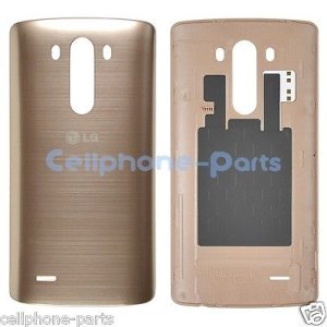

Ok, here is my 2 cents, I got sim free european version, 4 pins on the cover, just received Samsung S Charger Pad to use with my LG G3, it came with no AC/DC adapter, so plugged LG one with output of 5.0V, 1.8A and put the phone on the plate, it start to charge, but then LED was flashing once green then orange.... I read the booklet and it says the pad needs 5.3V and 2A or over, so I have used my iPad's charger which is 5.1V and 2.1A so amperage is good, it happens the same, even it says use LG adapter..... So no luck with wireless charging yet. On the box it says, use with certified Samsung adapters.
Should I return it or should I go for genuine Samsung adapter?
Second post: I think I've sorted it.
I've been using Belkin 1.8m microUSB cable, (I like watching youtube in bed) it is bad idea to charge the pad with long cables, it won't work, swap with original one from LG.
Because charging pad is small you must put your phone precisely, bottom edge of the charging pad, like just above launch icons on the phone, top of your phone is where pad's cable is. Will do some tests more. So in short: get a minimum 2A charger, get short cable more likely your chargers cable, check the best position for your phone, even 1mm can make a difference.
Just received my Quick Circle Case from VZW, and in spite of what their website says, the LG packaging specifically states this is a Powermat charger. Of course, had to try on my Qi charger; it charges for about 5 seconds then shuts off.

I ordered the same one from Verizon, and it works fine on my LG Qi charging pad. Now the back of the packaging does say, that it also works with powermat chargers.

I received my case today and it DOES NOT work with my Qi RavPower Charger. Mine also says "Compatible with POWERMAT Wireless Charging Product". It says nothing about Qi on the packing.
