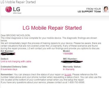

Has anyone else got a response from LG as a wrong diagnosis? I clearly told them that it was a bootloop problem before I shipped. They are trying to say it was a charging problem. Plus I have two batteries and a travel charger so there diagnostics is BS. It may not charge while it is in life is good mode. But both my batteries were fully charged when it went into bootloop. Capture.JPG

Don't take their stated diagnosis literally. They said the same thing to me on one of my repairs. They changed the main board under warranty, and all was well.

They are stating that my problem is a charging issue. I had heard there's a class action suit against LG on this. Maybe, they are trying to keep our issues our of any class action.
What do you mean by "they are stating your problem is a charging issue"?
Do they have your phone?
It doesn't matter what they call it, as long as they fix it. I think they called my second unit (I had two V10s) out with the same "won't charge" verbiage on their repair tracking system, but it didn't matter. They fixed the bootloop problem.
