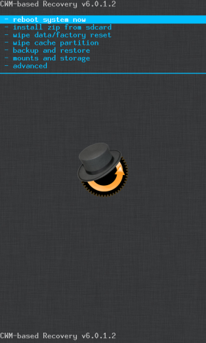

I'm wondering what to do about the recovery. The only think I can think of is it's missing it's init.rc and other rc scripts? You're more experienced in this department, what do you think is causing the bootloop?
Fixed bootlooping, and got it to boot into cwm.
Almost there, just have to fix keys. Little help Nigel :-[
Oh and Nigel you'll get a kick out of this. Reboot works! :p
Also feel free to make any changes and fix my dumb mistakes, and lets get our git set up!

The CWM issue is with the recovery_ui.CPP, I'll work on it as soon as possible which means right now.

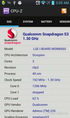

Edit:
Well I managed to get my kernel built and booting.
OC + smartassv2 kernel
I'll raise the overclock by more as I test it out.
