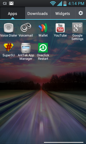

2014-04-24 16.14.46.pnglol awesome. anyhow, my cord was @ fault (earlier posts.) some ideas before going to work, 1) retry lgflashtool with iproj kernel 2) try rerooting zvk with custom stock kernel. will post results shortly. anyone wanna collab on how to make a bootable rom (loki)? i also flashed rom/flashed kernel (loki) seperately.stock or custom idc, custom preferably, maybe a device tree required.
edit :lol, reroot works. heres how. if yer rooted under zvk with voodoo ota rootkeeper as i was. simply flash recovery (lok), flash stock kernel (lok), disable current root under app settings, uninstall ota rootkeeper, power off, factory reset (i think required for unlock process, not sure, i did it anyway) reboot recovery, reboot from recovery. twrp asks if you want su, swipe to agree, navigate to yer apps after rebooting, click supersu installer, click play, click update, watch the supersu widget replace the installer widget before yer very eyes! lmao. not done yet, click the now supersu widget agree to reboot recovery, after rebooting, su. byebye voodoo (for now.)
edit: lgflashtool was successful after flashing iproj kernel, just needed a new usb cord, funtime.
