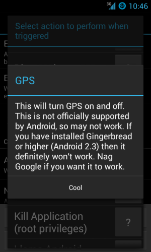

olivier - I cant get llams to trigger GPS either,
I have the same event as you (when Maps is active enable GPS) but it doesnt fire.
I think some Llama features only work with custom ROMs. I know I saw this warning somewhere but can't remember exactly. My screenshot might explain your concern (it's when you tap on the '?' icon next to what you want to add to an event)
That's an android issue. It doesn't allow third party apps to manage gps.
Enviado desde mi GT-N7000 usando Tapatalk 2
olivier - I am running a custom rom (Omega 43.3)
Secure Settings seems to have done the trick though.
