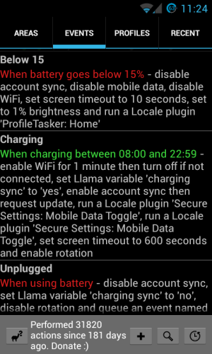

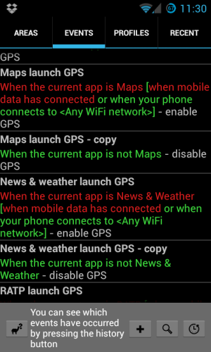

Llama can! I don't use Secure settings anymore except for toggling data twice (see attachments).
The Moto Droid Razr Maxx HD I have not been able to do this using llama directly. The only way I was able to do this successfully was using secure settings as a locale trigger to accomplish GPS. GPS is the only one that I have not successfully gotten llama to trigger by itself. Thus my need to use secure settings.

I have also tried this set up and for some reason llama won't trigger my second event. Essentially leaving car mode activated when it should be off.
olivier - I cant get llams to trigger GPS either,
I have the same event as you (when Maps is active enable GPS) but it doesnt fire.
