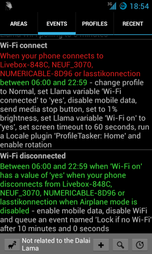

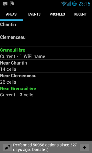

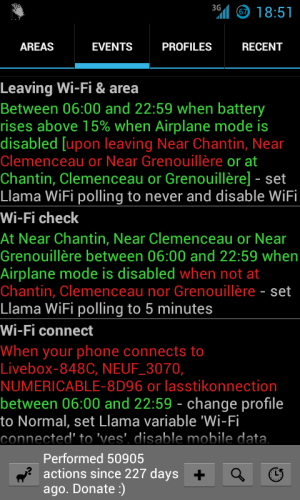

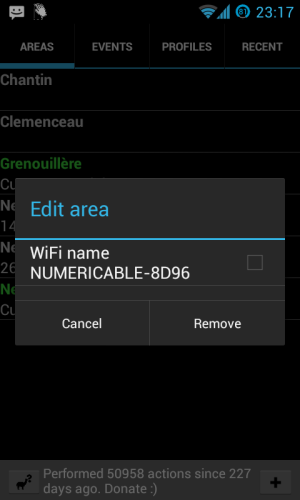

What I meant is I'm home but the wifi polling event didn't trigger. screenshots will show how.
"grenouill?re" is home for me. Let me know if I did something wrong
with reference to WIFI Name in a particular area, I have 4 areas, all of which have a known Wifi. But only one of those four in "My areas" have a recognised wifi name (as well as 30-40 cells)
How do i add a wifi name (ie a wifi SSID) to an area?
Wifi polling has to be enabled in settings first. Go to the Recent tab, long press on the Wifi name or Mac and add it to the desired area
