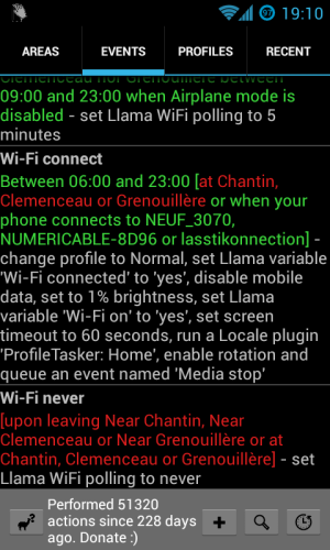

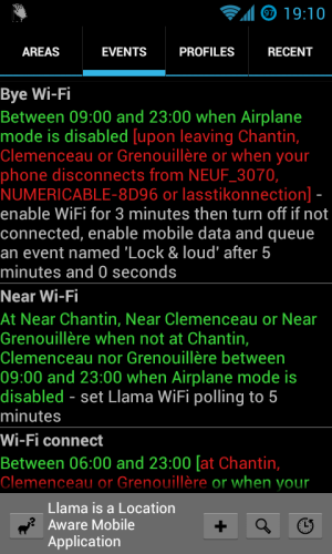

This is weird. I've cleaned up my WiFi events and just noticed that the WiFi polling to never action keeps the WiFi on forever. Shouldn't it do the opposite kurokirasama?
What I meant is I'm home but the wifi polling event didn't trigger. screenshots will show how.
"grenouill?re" is home for me. Let me know if I did something wrong
First, if you are at home at llama think so too, then at some point wifi polling should have been enabled, isn't it?
To be sure, when you get at home, check the recent events list and see what happened.

I'm not home, but as soon as I get a chance to replicate the events, I'll take screenshots and post them.
My previous wifi events screenshots are old because I've cleaned them up. I've uploaded new ones

I don't exactly see mistakes, but here are some things you could do to improve them.
- Bye wifi : instead of turning on wifi for 3 minutes, turn it off immediately or queue an event to turning off after 3 minutes, so it doesn't interfiere with wifi polling, besides, your wifi is already turned on.
- Wifi connect: this might cause problems. When you enter our wifi areas, wifi is Supposed to be off, only wifi polling turn it on and off, so you are missing here to turn on wifi. Thus, you should do the same thing (near home, home) with those networks you have there, or you will have to treat them differently.

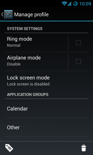

I've encountered issues with this feature, unfortunately it's common (i.e. when pattern lock is disabled, when you open a notification, pattern lock enables for Android Security reasons (this happens with Tasker too)). I have a Samsung Nexus S, rooted running CyanogenMod. The only solution I found is to use CyanogenMod's profile switcher (see attached screenshots). I use Profile 4 Tasker + Widget as a locale plugin to active my desired profiles.

If you can flash CyanogenMod on your device, try my solution.
