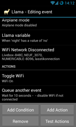

Your Near wifi event is delayed, note that because of that delay, its queued event will fire either 10 seconds after the actual event's conditions are met, or 2 minutes and 10 seconds after.
I've noticed that variables don't play well with queued events, I guess they only work when in conditions or actions of an event.
I would suggest for your Near Wifi event (as sometimes you might not be near your known wifis in 2 minutes when entering home or work areas) :
to make it a repeating event and make it turn "wifi off (if not connected)" in a queued event which is already implemented in Llama, no conditions nor variables needed.
