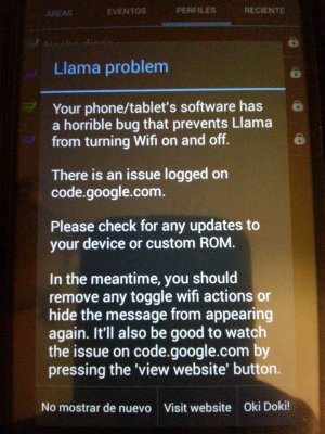

Llama ran fine fore me on my 4.2.2 CM based ROM, but once I updated to 4.3 I ran into the same problem. One exception however is that it seemed like it had an effect on successfully firing events on time or at all. I reflashed back to 4.2.2 and after re-installing llama I'm running into the frequent error notifications and situations stating "Llama could not get root access in time".
Any thoughts on what I could do to troubleshoot?
