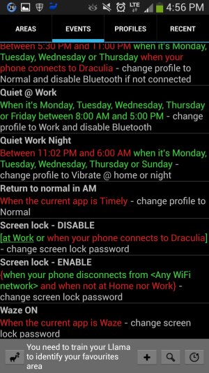

Hi guys,
I have been reading these forums for sometime now and I NEED your help!
I love Llama and I HATE Llama!
I am not a newbie with android phones...
I currently have this setup for Work:
Mon-Fri, 8-5, Vibrate (gave up on tower cells for Work area as they keep disconnecting)
EACH TIME there is a call, my phone switches to Normal and RINGS! It started to upset people in the office.
What could be the reason to it?
Normal, cottage, screen disable, wi-fi ...all works fine! except for WORK events.z

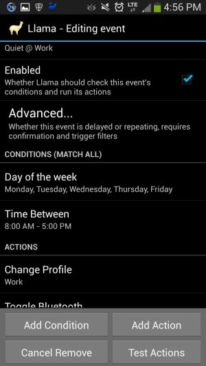

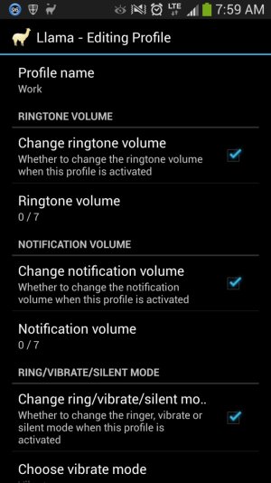

Could you post the details of the event and profile you are having the issue with?
Hi,
thank you kindly for your help!
I use Quiet @Work Event and Work Profile
I have attached these images:)
I have a similar event (minus the Bluetooth action,) and the only difference is that under Conditions, I have days (just like you,) but unlike you, I have time nested under the And condition. My event works 100% of the time, so why don't you give it a try?
