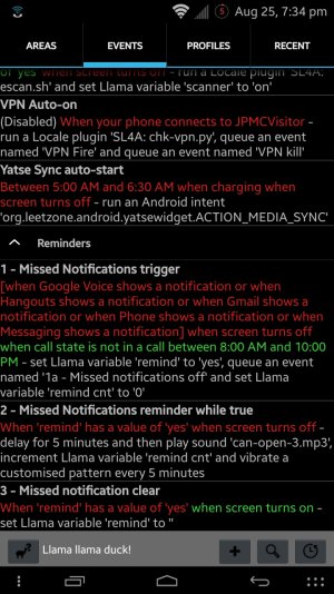

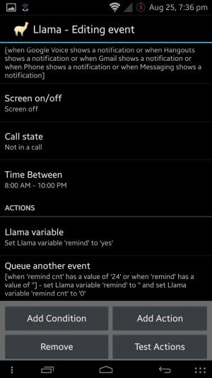

Hi I've been using Llama for a while now but I can't get the condition known as the app notification bar icon to work. I have a HTC One and it only will notify you once when you miss a call, get a Visual VM or Message. I wanted to set it up to remind me every minute.
What I have:
Conditions
Charging status - Using Battery (so it doesn't happen on the charger at night)
When Messages shows a notification OR when Visual VM shows a notification.
Action
Play sound "Button"
Vibrate Pattern 0-500
Also on the Advanced tab I have it set to repeat event every one minute.
I have Llama set to device administrators privileges and Llama On in the Accessibility section.
Never works though. Any other ideas what I've missed.
