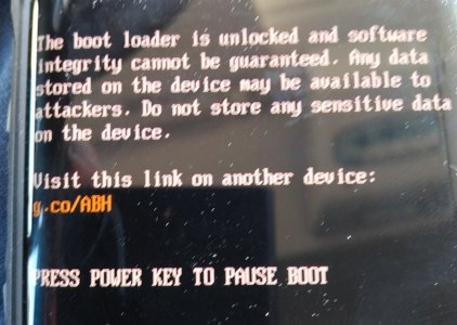

Here is attached picture of start up screen

You should be able go into fastboot ,in command window type oem lock bootloader with phone connected to computer

Bootloader unlock has nothing to do with sim unlock, you need a sim unlock to use on other carriers
To see if unlock would allow the phone to run off Mint Mobile rather than T-Mobile. I paid cash for phone and ran it on tmo until they said I had permission to unlock boot loader. So, that's reason why I unlocked boot loader, apparently the phone will never be allowed to run anything but tmo. Phone calls go straight forward vm with no notification. I'm simply relocating and going back to tmo prepaid, I've been working on this for 3 months, worked with tmo, oneplus and mint customer service to no avail, it would have been best if tmo would simply state it was stuck to tmo, would have saved me hours of going back and forth
They are two different processes. You can get an unlock code from T-Mobile to use your phone on different networks. Requirements are usually a complete payment and using their network for some minimum time. After that you enter the code in the carrier app, follow instructions and done.
Unlocking the bootloader is completely different. With branded models, like yours, is usually used to flash the international ROM over the T-Mobile one. There are many reasons why people do this and it's quite straightforward in OnePlus devices. The catch is that the 7T 5G McLaren is a US (T-Mobile) exclusive model and the international ROM doesn't exist. You are stuck with the stock ROM that comes with the phone, well, or custom ROMs that will need a lot of experience and come with risks and problems.
I think you need to lock the bootloader back (it will imply a full wipe again) and go one more time through the much easier process of network unlocking.
