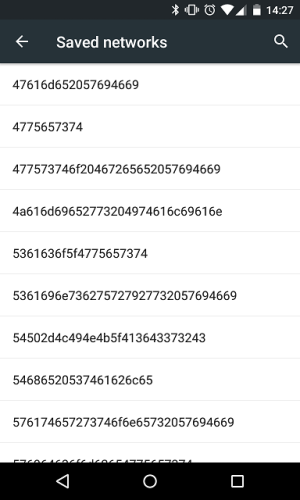

I found that there were a huge number of networks with names that were strings of letters and numbers.
To remove saved networks open 'Settings' and choose 'Wi-Fi' (and wait for it to load).
From the 3-dot menu choose 'Saved networks'.
You should see a list of networks in a similar format to those shown below:

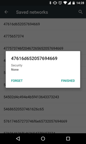

Remove any you don't recognise (tap the network name and tap 'Forget'):
Once all of the unrecognised names have been removed the list of WiFi networks should load without freezing the system.
NOTE: I have found that this can occur again after a while, in which case repeat the steps above.
