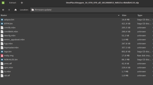

I have my OP3 refusing to boot, I can go into fastboot / recovery mode but that's it.
I have as well flashed everything (stock) in EDL mode with MSMDownloadTool and everything went fine (tried both methods).
However the result didn't change, still even with the new *everything* the phone refused to boot, and onl the led light was on.
Someone would tell, Wait... You did the full MSMDownloadTool procedure, it went all green, and aren't giving up?? (send it to the support , so they can charge a motherboard and it's as if I would buy a new phone)...
Yes, and the reason for it is that there is this "tampering" function in emmc_appsboot.mbn https://ge0n0sis.github.io/posts/20...-mode-using-an-undocumented-feature-of-aboot/ that does exactly that, even if the phone is well and sane, it will refuse to boot. But that can be changed if I try to start the phone with an unlocked bootloader and TWRP as recovery.
If that's not the case, at least it will give me the chance to load a kernel with fastboot and see why the heck isn't booting up (at least will have some debug information if there's a hardware issue and understand when why / how).
So, I'm quite sure there's some user with OP3 with the secure boot disabled and the bootloader unlocked, can you please get the firmware files and toss them to me? (check the attachment for the files I need)
Afterwards I can reflash everything with MSMDownloadTool and hopefully will find the phone with the unlocked boot and secure boot disabled.
Important note: I can't unlock the bootloader from fastboot since I can't login to the OS itself.
Thanks!
