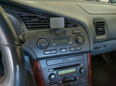

Very happy with the low profile of the new Koomus magnetic holder. Very strong hold for Nexus 6P in the CandyShell Speck case.
