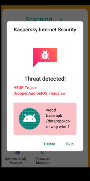

Thanks @B. Diddy for your information.
I got some more info which I thought would share in the forum if it helps.
I have installed Kaspersky Internet Security for Android mobile and scanned my phone with it.
It has detected a trojan with the name wqbd (screenshot attached). I have deleted using the trojan using it.
Till last 12 hours it did not come back. I will update after 24 hrs about the status. I can only hope and pray
it does not come back again.
Regards,
Mave
Thanks for that info! Very concerning. Other phones have been found to have some variant of Triada malware included out of the box: https://www.cnx-software.com/2018/03/06/over-40-android-phone-models-ship-infected-with-trojan/. Since only Panasonic phone have been mentioned in this thread, I would guess that somehow this malware has made its way into their firmware, or into one of the system apps. If Panasonic won't respond, then I would seriously consider moving away from them and switching to a different manufacturer that is more trustworthy.
