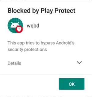

if we enabled google play to protect notifications we will get a notification this app is trying to bypass android security and also asking to install just ignore the notification it will not install .use another web browser like Opera mini firefox.

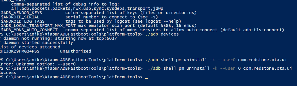

Step 6: Now enable Developer option and connect your mobile to PC via adb. (google for more help)

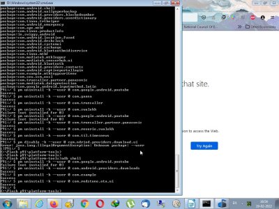

Now (as per screenshot) remove these packages from your system especially download manager and system update (some apps might not be present in your mobile but these two apps must be present and should be removed importantly.
Connect via adb and enter command: adb devices and check whether your device is recognised. Now enter command: adb shell and press enter, then write the command
pm uninstall -k –user 0 com.redstone.ota.ui
when screen shows success, enter next command
pm uninstall -k –user 0 com.android.providers.downloads
pm uninstall -k –user 0 com.example
