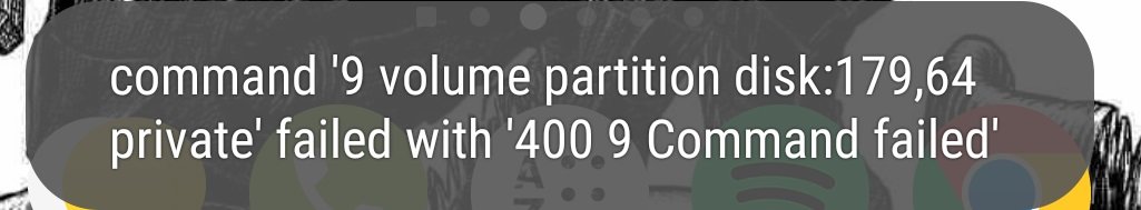

To clarify, this message shows up when trying to reformat the SD Card for use. Otherwise it says the SD Card unreadable and needs to be reformated.

WOW Javier, this looks to be the exact issue I'm having. This only started with the Marshmallow update, so I'm certain that the SD Card itself is not the main issue. I'll try out the steps described tonight and get back to you on what the results are.
