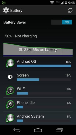

My Android OS is at 50%. Is anyone else's that high? After the 4.2.2 update is when my batter life started to really suffer.
Have you tried clearing cache in recovery? That might help.
I know these steps are for the Nexus Tablet line, but I think the process is still the same. (I never booted into stock recovery. Once I flashed a custom, the process often changes.)
http://forums.androidcentral.com/go...e-nexus-7-2012-2013-cache-partition-wipe.html

Here is my stats, the Android OS is still killing my battery.
Sent from my XT1053 using Tapatalk

Looks like poor mobile signal did most of the early drain.
