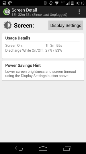

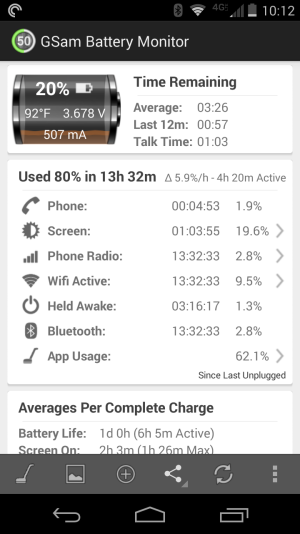

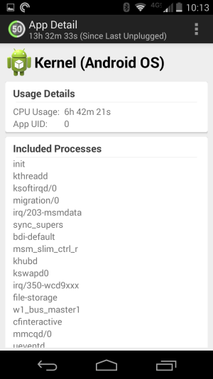

I have noticed significant battery drain lately. When I first started using the Moto X I was getting 24-30 hours easily with moderate use. Generally I will only have 1-2 hours of screen time. Now with the same usage I am only getting 12-15. I have noticed that Android Kernal is the main offender, but don't know what that is.
  • Not Rooted
  • Screen brightness 50%-60%
  • Notifications turned off on all apps
  • Don't even have that many apps that I use
  • No gaming
I have attached screen shots from Gsam:
What gives?????

I'm still new to Android but looks like 62% of battery drain is from App usage, so you are either using one or more battery hog apps a lot or one has gone haywire. I find that generally the Screen is by far the largest battery suck.
Also try putting your screen brightness on Auto. I find that the screen is generally more bright than I need it, even doing that.

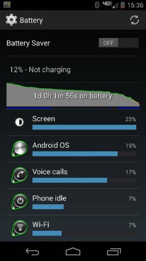

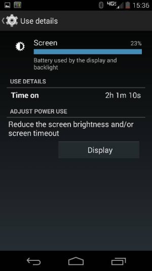

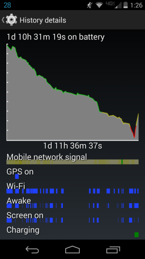

You probably have a lot of stuff running that doesn't need to be, Including Motorola and carrier bloat.
Since 4.4.2 hit Verizon My Stone Stock android is getting amazing Battery life (For an Android small Battery device) that is.

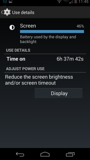

There are certain things that must be done to every Moto x and androids to get usable battery life. Most on these forums will argue against them, but the numbers speak for themselves. None of them require Rooting, unlocking bootloaders, Custom Roms or worthless battery apps etc.
34 Hours off power
10% Battery life left
49 Minutes of GPS
1 hour 14 minutes music streaming
32 minutes on the phone
And 6 Hours 37 minutes of Screen on time!
I forgot to take the history details screen shot, so I took it 2 hours later while the phone was recharging/ Which is why the over all time went from 1D 9H 54M to 1D 10H 34M and why the clock goes from 11:45 to 1:26 and the battery from 10% to 26%
Screenshot_2014-03-05-01-26-34.pngScreenshot_2014-03-04-23-44-58.pngScreenshot_2014-03-04-23-45-02.png
34 Hours off power
49 Minutes of GPS
Yeah...but from reading your posts it looks like you disable almost everything that makes the Moto X special. What is the point in that? If you don't use those features, sure fine go ahead but most people probably enjoy using Google Now, Active Display, Touchless controls, etc.
