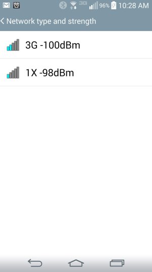

While normally I'd agree with you, my other phones survived my desk all day with plenty of juice left for the evening. Here's what I got sitting here:
Hmm, maybe have Verizon CS do their signal reset process. They've done that over the phone for me when I had them years ago and it worked. Just call from another phone than your G3
The other phone had another radio. In that location it may survive better.. Whereas the G3 can maybe survive better in another.
It's hard to expect the exact experience with every phone.. Different hardware and radios.. But usually a huge drain and weak signal go hand in hand.

As I said, normally I'd agree. Low Signal = Poor Battery. However, I've had the following at my same desk as the G3 with no battery drain:
Razr Maxx, Razr Maxx HD, Sammy Galaxy S3, HTC One Max, HTC One M8, LG G2.
That would be my guess to the battery drain. I'm always 4G and getting 20mg download speeds avg.
That's why I said different phone.. Different radios. You have a weak signal and drain... Others don't have weak signals and I haven't seen many people complaining.
Just saying that's usually the cause. Go exchange if you can.. You may have a faulty phone.. That's always a possibility as well.
