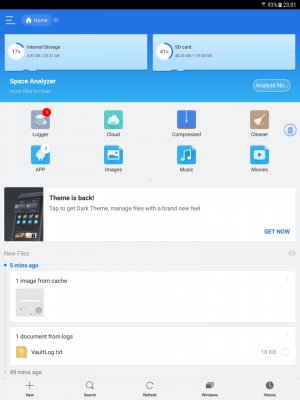

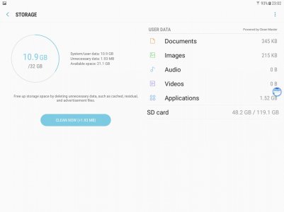

Would you mind looking at these screenshots from my tab s2. One is from my Device Management system and one us from ES Manager. The descrepency between the amounts of Internal memory used still has me stumped. I cleared the memory from my Amazon music app and it had all definitely been stored on my SD card, also my app memory went from 10GB to 1.5 but the total used didn't alter at all. Am bigly confused.

I think that discrepancy represents the OS and preinstalled bloatware. The system menu shows 10.9 GB out of 32 GB used -- since it's using 32 GB as the denominator, that means it's accounting for the OS and bloatware (which usually takes up anywhere from 3-8 GB, depending on the device). ES File Explorer is reporting 4.32 GB out of 25.41 GB used, so ES is not including the space taken up by the OS and/or bloatware (which would be around 5.5 GB).
You need to stop comparing the results you're seeing from those two very different utilities. One is the system manager that's polling your Tab's total internal storage media, the other is a third-party utility that only has access to the one partition, the user data partition where all your data and apps you install are stored.
Your Tab's internal storage is divided into different partitions, most are dedicated to the operating system (the Android OS you interact with) and then there's a single, user data partition (/data). You have very limited access to any of the system partitions (unless you've rooted your Tab) so it's more or less irrelevant, those system partitions are restricted and you only have the ability to add/delete/alter content that resides in that /data partition.. Also, a utility like ES will primarily show you what its developers want to show you, that is the alleged 'miracles' that using its clean up function can do make your Tab run better.
