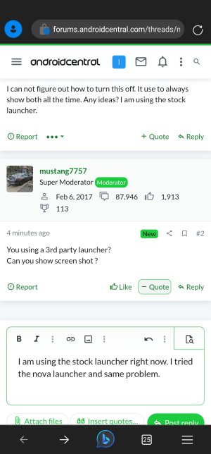

My navigation bar and notification bar auto hid after a few seconds
I am using the stock launcher right now. I tried the nova launcher and same problem.
