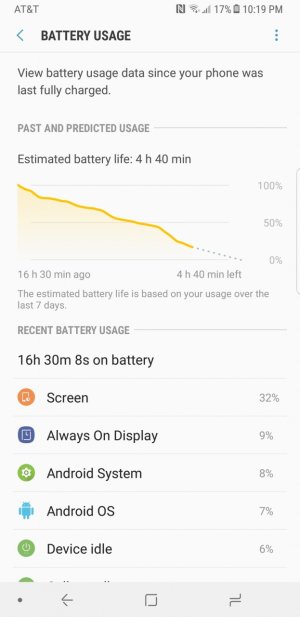

How much screen on time?
Probably 4 or 5 hours. I was on it a lot today. Under normal circumstances I'm one of those people who plugs in a charger at every opportunity, but I wanted to test it today.
I think it did pretty well. As good or better than my old iPhone 6.
Today. Not usually on it as much as I was today I think so checked SOT from first time.
