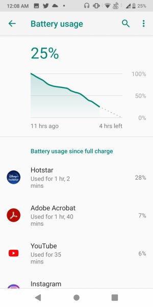

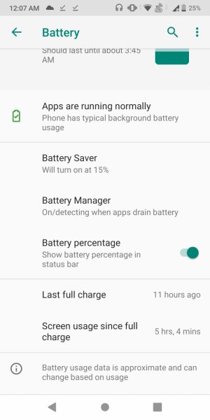

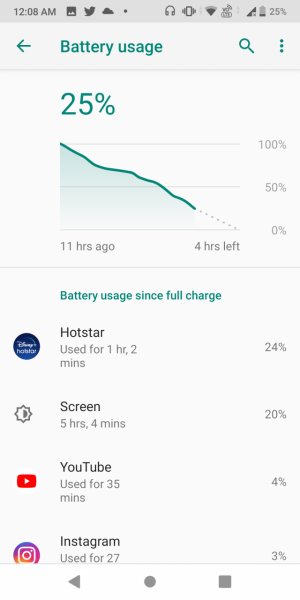

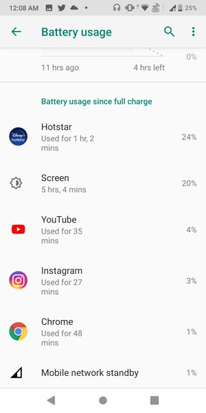

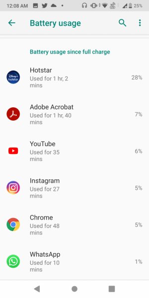

This is my battery usage and other information you asked for

Were you using Hotstar this much before? Also, it'd still be helpful to see what your cell signal has been like, since poor signal can increase battery drain. GSam Battery Monitor is the easiest way to see your cell signal over time.

Should I charge it to 100% again and then again collect data at 20-30% or is it fine at the current state of (73%)?
Also I don't use hotstar that frequently because rarely it has things to binge watch or a movie worth watching, but an hour of Netflix episode would cost me 10% battery. I am not sure about hotstar but it definitely wasn't this heavy. It costs me almost 30% for 1 hr right now.
