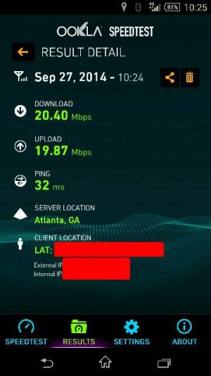

My first speed test on 4G.I'll run another one later.
Great news on getting it resolved, that's definitely LTE speeds just odd it only shows 4G icon though.
Those are some decent speeds. For some reason my server location is showing up in Chattanooga even though I'm closer to Atlanta. I'm getting less than half what you are getting. I'm on an AT&T M8. I have kinda noticed that my iPhone 5S consistently got much better LTE speeds than my M8 does though.
