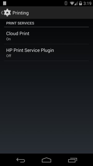

Have you tried turning off the HP print option and only leaving the cloud print option turned on?
I don't have the CloudPrint option like the video - CloudPrint is installed but doesn't appear as a print service in Settings > Printers. I expect that's the issue, something I don't understand how to do or have configured incorrectly. Thanks for your suggestions!

I can't post screen shots from this app - but I don't have the CloudPrint service displayed, only the HP plug-in, and i think that's the problem. The update didn't install it so I installed the CloudPrint app. But no CloudPrint service. How do you get that to install and display?
Posted via Android Central App with my Droid MAXX
All I did was install the app and it appeared. https://forums.androidcentral.com/e...google.android.apps.cloudprint&token=bMJT6wEl
Maybe try uninstalling the app and then reinstalling it.
Thanks for the link! I had installed another app of the same name, but a closer look shows it is not signed by Google! I uninstalled it and then installed the correct one - and now Cloud Print appears in Settings > Print.

Mystery solved! The Cloud Print app I'd installed was not Google-signed. It worked fine for cloud printing but not for direct-from-KitKat printing. After installing the correct app, Cloud Print now appears in Settings > Print and I can print directly from my Droid. Also still works to long-press a Drive document and print. And for apps that do not yet incorporate the Print command I can send the doc to Drive and print from there. Yay.
