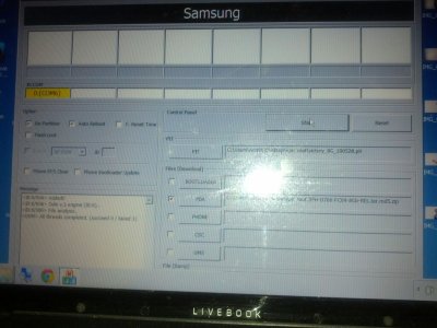

I tried two computers and watched qbking video and when I click start is says < OSM> All threads completed succeed 0/ failed 1) I have the epic 4g
Okay from looking at your screenshot two possibilities...
1. Uncheck the repartion box... That shouldn't be necessary unless you were running a custom ROM that was using the MTD format.
2. Your tar file in the PDA slot.. I noticed the extension on it was SPH-D700-FC09-8Gb-REL.tar.md5.zip, using a file explorer like Windows Explorer name the file so you loose the ".zip" extension and give that a go..... Make sure you have it set to show extensions in your file explorer so you can change/rename it.
I think the ".zip" is what is causing it to fail.
Report back and good luck.

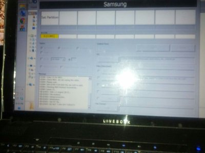

That worked it went through thanks :D now it just says set partition
I'm using cm9 and when I rooted the phone I used a mtd file
Try running it again without the repartition selected.. Use the pit file just don't check the repartition box...

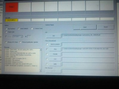

It says fail in the first white box. It also says can't open the serial (COM) port
Not what I wanted to see.. Try using the repartition box again and see if it will go thru... Darn MTD ! This is where I stepped off my Epic 4g when they started with the MTD.. While it was a great thing I also saw problems from time to time when unrooting/restore to stock with this partitioning of the file system from MTD back to stock RFS....
Its going through I used my other computer. Thanks a lot :) it passed my phone is unrooted now.
