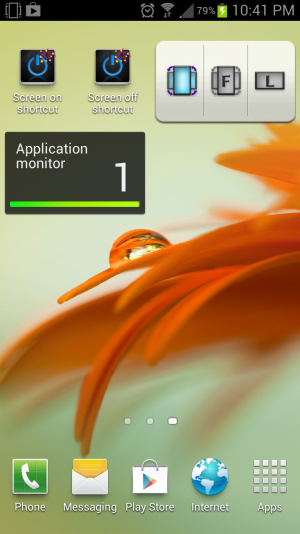

Here is a very good widget that shows you when a app is eating cpu time while idle. For me its green and shows 1 app running, it can show 15 or 20 apps in idle and still be green. Other tine it will show 2 or 3 apps and it will be red. Red is bad, click it the widget and it shortcuts to your taskmanager and shows you which apps are utilizing cputime and which are not. Close the bad apps and save your battery life.
For whatever reason tapatalk wont let me upload the picture. The widget is called application monitor and you will only find it in the samsung appstore.

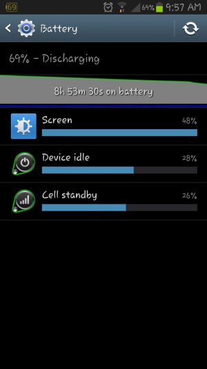

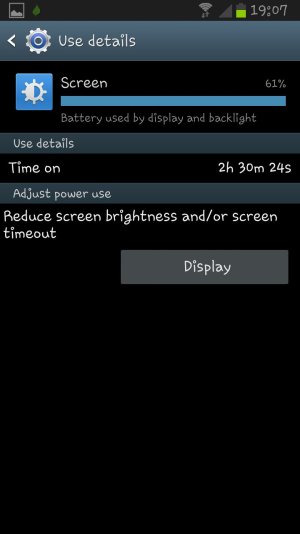

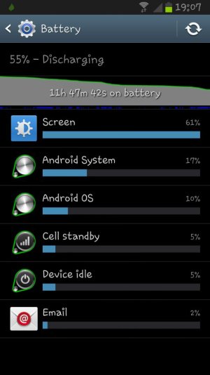

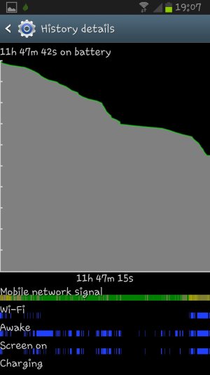

Hi Joe.
Could you post your battery history details and screen-on graphs. They can provide more info.

To me it looks like I have a problem with my phone always being awake, even when the screen is off.
How do I fix that?

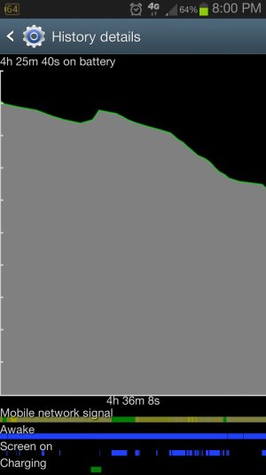

How do I fix that?
Sent from my SGH-T889 using Android Central Forums
There is a wakelock keeping the phone awake non stop. Have you checked the settings from my previous post
