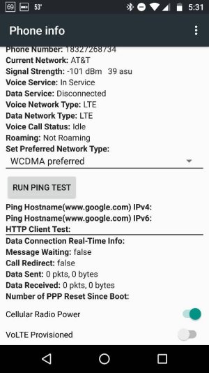

Download this app from the play store...
https://forums.androidcentral.com/e...tails?id=com.ather.networkmode&token=BwVRV4GG
Open it up and scroll about halfway down. There's a field for a small drop down menu. Make note of what the default radio setting is at (mine was LTE/UTMS I believe). Switch it to WCDMA preferred or WCDMA only to switch your radio over. You can switch it back anytime. If the phone is shut off or put into airplane mode it will automatically revert to it's default radios. Cheers.
