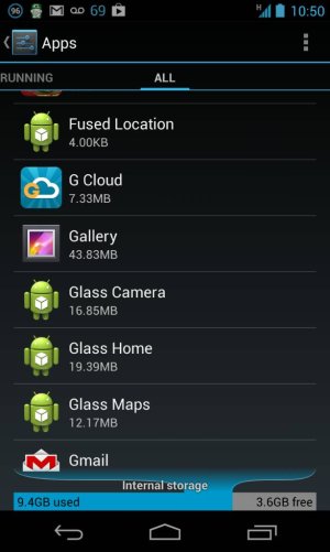

I did it myself as well. Did you check the locations I gave to see if it is in both locations? I had a similar situation with Quickoffice. It comes installed by the OEM and I already had the pro version. When I installed the pro version it just took over for the OEM version, despite them still both being installed. The OEM version in system/app and the pro version in data/app, no overwriting involved. You could also go to all apps in settings and see if Gallery is listed twice to find out. I have Quickoffice listed twice. Despite both versions being installed, only the pro version shows in the app drawer.

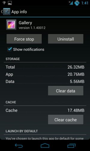

Thanks. Just to confirm, if you open the properties for gallery, does it give you the option to uninstall or the option to uninstall updates? Sorry for all the questions, but this may help me with the installation of something else.
Edit: I notice that your Gallery is 43mb, when mine is only 26mb. I wonder if you have both merged in some way.
