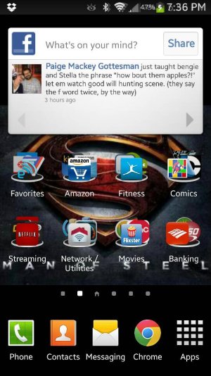

Hey, guys... Upgraded by simply flashing into recovery mode after moving the raw file to my SD (didn't have to change the file name) and everything went smoothly. Update took close to 15min to complete. It was pretty slow and thought something might error out, but it finished fine.
Anyway, I'm noticing what looks like double-vision in the notification field at the top of the screen on occasion. The icons for bluetooth, wifi, battery percentage and the time look like they have shadows behind them. It goes away every so often. Haven't found anything in the settings to adjust it unless it's a small bug maybe. Haven't played around with what may be new either. Anyone else seeing this at all? It doesn't happen on the lock screen apparently. I attached a screenshot... Have a look at the top of it.
Strange, haven't noticed that after updating, however I'm using Nova launcher if that makes a difference and it's something only showing up with the touchwiz launcher.
Weird, I know. The double-vision of the icons on top only happens when I'm swiping through my home screens. Once I start an app or wake the phone to my lock screen, it's not there. In using stock Touchwiz.
