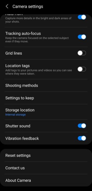

In camera settings do you see storage locations ? My screen shot Screenshot_20210928-121845_Camera.jpg

Yeah we trying put you on the right track by not allowing the sd card as internal storage, so we got that cleared up , now in post i believe #11 i used a screenshot from my Samsung Note 20U camera app settings when i open it , you see storage location in my screenshot ? Does your camera when you open to settings have that?

In post #8 you did mention you made SD card into internal storage , that's where we all saying revert it back the SD card to portable.
The camera app settings also have option to place pictures in internal storage or SD card .
Hopefully that clears it up, 2 different things .
So yes to the camera settings being set to SD card when pictures taken ?
Yes you changed the SD card back to portable?
