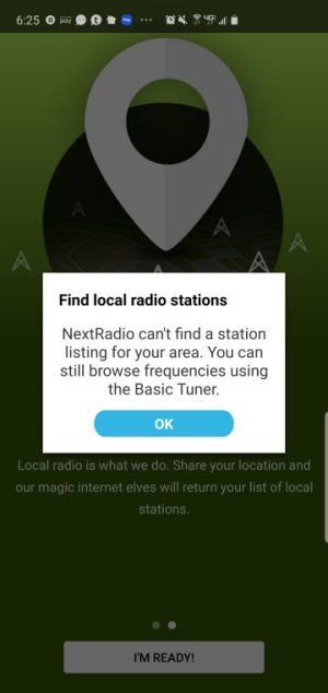

Is this the error you got?
If so, it still works you just scan manually or enter stations. You just can't use the guide
Yes, that's the one. What's weird is I was able to input my zip code initially when I had the Prism White, and I was able to use the guide. Oh well, thanks for letting me know.
