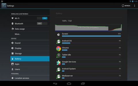

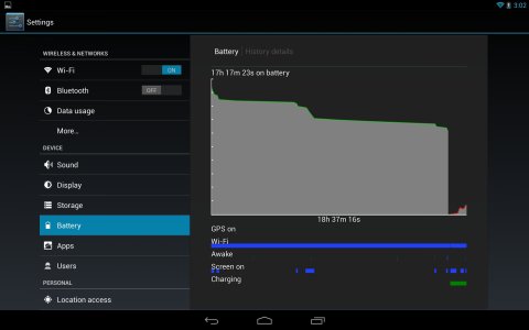

Hi all,
Had a nexus 10 for about 5 months now problem free......
Except lately the battery seems to drain extremely fast lately. Fast as in a jump from a high percentage to zero. The tablet will have a high percentage then seem to lag, and then bloom it restarts and cannot boot cut the battery is 0%.
I've specifically noticed this happening when in the camera app, but that is not the only case.
Any help, guidance, suggestions, ways to fix, is greatly greatly appreciated!!!!
Hope the attached pics help....Screenshot_2013-06-23-19-23-37.jpgScreenshot_2013-06-23-15-02-22.jpg
You will probably need to do a factory reset, but for kicks, turn off wifi completely and recharge it and see how long it lasts.
Tried both of these.
Factory Reset last night and just encountered same problem.
Drained from at least 85% down to 0%.
Any ideas?
