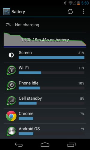

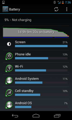

i had to send my 1st nexus back because it shipped with a scratch. what i found in the 2 weeks that i had it was that the battery life was mediocre, at best. in a typical day, i would get 10hrs of battery with light to moderate use. i tried all the tricks except rooting and flashing a new kernel, because honestly, i don't think i should have to do that with a battery this large to get very good battery life.
my warranty model came this weekend and i decided to test (non-scientifically) how well the battery did if i ignored the initial system update prompt, unlike my first go 'round. i received it friday, around 7pm, and it was fully charged out of the box. i put a skinomi on it and let it dry over night. i began to use it over the course of the weekend, lightly on saturday and more heavily on sunday.
i would consider what resulted phenomenal battery life. here's the thing, with my first nexus 4, it would lose 15-18% battery life over night. with the warranty nexus 4, it only lost 4 percent over an 8 hour period while i was asleep.
for those who have yet to receive their nexus 4, i would seriously consider avoiding updating the software just to see how your battery life is. for my part, i'm incredibly disappointed that google shipped software that devastates the battery this badly. i'm hoping they come out with a fix it, mostly because i'm tired of the "system update available" notification and because battery seems to be the major gripe of many users. if someone has similar results, i would love to hear them

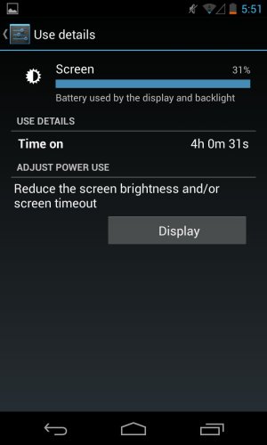

Here is my battery life. It is still not hooked up to a carrier, and the reason for the big dropoff is because I was trying to drain the battery.

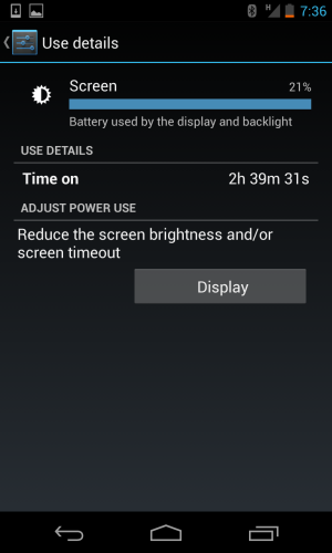

This goes with the one above, just forgot to use it.
