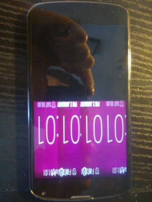

Nexus 4 Carbon Nightly Problems
Hi, so I have a Nexus 4 borrowed from a friend and he is running on it Carbon Nightly and yesterday I turned on the sync, and at some point asked me to reboot the phone to update, which I did. It turned on in recovery mode, showing that it is installing carbon. So far so good. As I rebooted the phone, it turned on but the screen is not working. Now the screen in either yellow and purple or half is black and the other half is enhanced forward. I must mention I have no experience with rooting Android. Mostly I am afraid that the personal data in the phone will be lost if I do a hard recover, although I have no idea at what point will that restore the phone. I really don't want to lose my friends data. Could I make a back up (save the data, picture, videos, documents) from the recovery mode?
Thank you for any help!
