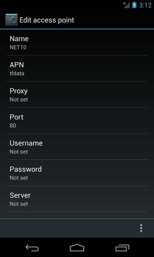

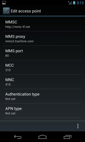

Re: Net10, can send MMS but can not receive MMS
These settings fixed my issues and I send and receive just dandy. I'm on at&t net10
