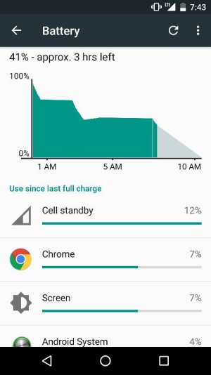

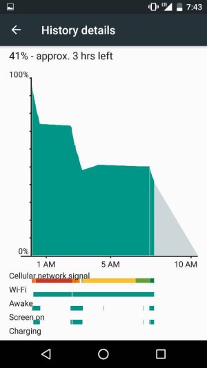

I'm not sure if this is what you asked me for. This phone's battery is literally draining like hell!! I switched to carrier internet connection and turned off WiFi didn't use it for sometime but same old backup..

The high Cell Standby indicates poor cell signal, which can contribute significantly to battery drain (since the phone's cell radio has to work harder to maintain the signal). The Cellular Network Signal bar looks red when the battery level is dropping steeply, which supports this theory. Does the drain happen when you're in an area with good signal?

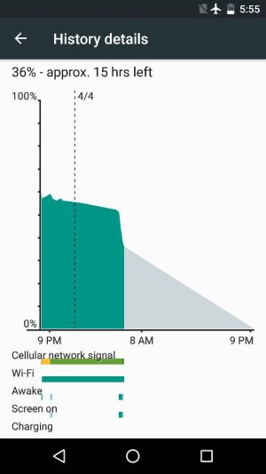

Here is the ss of phone with airplane mode on. I used if for some time and yet battery is draining also it's showing cell network signal in Yellow!! Problem in hardware?

Strange that it still shows the cell signal strength bar when you have Airplane Mode on. In any case, I'm afraid I can't explain why the battery still drops so steeply. If you hadn't replaced the battery, I'd chalk it up to an old, degraded battery. Where did you get the replacement from? It's relatively unlikely, but still possible that the replacement battery might be a bad one.
