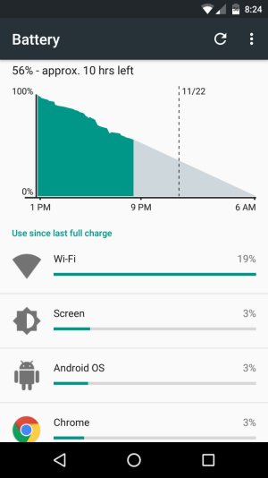

Well, after a week, I have to say I'm doing pretty good. 1hr SOT today, and moving around town (so, not a lot of Doze), 10 hours later, I'm at 63%.
What is your best SOT, I am thinking of replacing the battery on my Nexus 5 as well. But I am getting around 2.5 to 3 hours SOT. And really pathetic signal at my work so the drain is quite large. However, my Lumia 640 sits right next to the Nexus 5 and does not drop a whole lot during the day, go figure..
