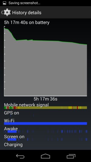

The first hour or so has a lot of awake time even though you don't have the display on that much. I take you're not rooted? Might be interesting to see what apps like BetterBatteryStats can reveal.

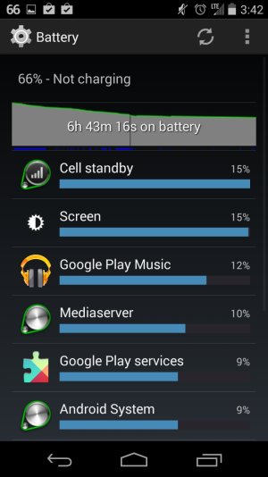

I think that was my music. I play music on my commute (about 45 mins). It's in my pocket playing, but screen is off. Google Music Player and Mediaserver are usually near the top of the battery usage list immediately after my commute.

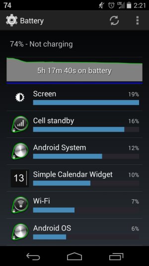

However, the little individual bars of "awake" is a bit of a mystery. I am not rooted. Here's what the list looks like around the time I took the screen shots:
Again, this is pretty normal usage pattern. I don't use my phone that differently from day to day. It's usually fine doing the same things I do, but once every 1-2 weeks, there's a day I need to reboot because something is draining the battery abnormally fast. It's very tall-tell when it happens. The graph is extremely steep for no particular reason. I've kept a careful eye on my daily usage patterns (what I run, what I install, etc.). There's no rhyme or reason.

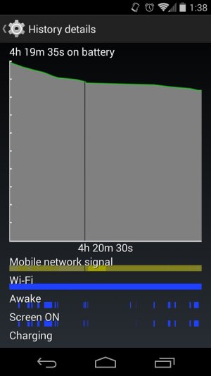

As you can see, it's fine today. Same usage patterns and same cell reception.
Then in a week or two, it'll suddenly drain really quickly for no apparent reason. Reboot, rinse and repeat.
