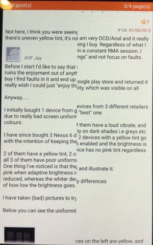

I'm also having the issue where half the screen freezes or turns black. I thought it had something to do with changing the screen density, but it does it with the density unchanged as well. I'm going to call tomorrow and see about getting a replacement before it's too late.
I have the screen freezing left to right. Sometimes offset in the same app, today the left half was one app and the right half was another app. It happens once every 2-3 days. I still have few days left in my initial 14-day trial so I'll be swapping it out.
Before I return mine, are we pretty sure the split screen freezing is hardware and not something that can be fixed with an update?
Excellent question.. To me, it feels like it's software related just based on the manner of the glitch.. Mine will freeze one half of the screen on the current app, i can press home and then the other half turns to my home screen.. both sides are displaying an image, one is just stuck.. There is no real technical basis on my assumption other than that's just the way it feels... feels like a software glitch.

Would the NuPlayer cause this to happen even when you aren't watching a video? I'll just be on a browser page or scrolling thru the home screens and it will freeze up as well.
Edit - So i just disabled NuPlayer.. opened up a game.. and a minute into it it's doing the same thing, half the screen stopped working. So at least in my case, NuPlayer doesn't seem to be the culprit
The only issue I have is the split screen issue, and it only happens in the morning when my alarm goes off. The left half is completely black while the right half works properly. Luckily, the right half is where the option is to turn off the alarm :)
I have not noticed this issue with any other apps or at any other time. Mine I got from ATT in store right around launch day. Also, I took a screenshot while the split screen was occurring to help determine if it was a software issue or a problem with the hardware displaying what the sw requested - the screenshot came out as a fully working screen. I'm not sure what level the screenshot app works at, but seems like it's either a hw issue or a display driver issue.
I did the same thing as you, i took a screen shot just in case i couldn't duplicate the issue while i took the phone into the store, the screen shot came out as normal, without the glitch. However, i was able to duplicate the issue while in the store anyways. Happens when i'm playing a game, a youtube video and just whenever, i could be scrolling thru the main desktop screens. Today is day 14 of my 14 day trial, so i'll be getting it replaced just in case it's a HW issue.. i don't want to be stuck with it and have it get worse over time. If the new device does it.. then i'm not sure what to do at that point. It did this while stock, i rooted and tried a custom rom, i disabled NuPlayer.. still happens. I'm hoping it's maybe a bug in lollipop for our phone / driver issue.
I too have the same issue with split screen. Top half will freeze and bottom half will continue playing the video but with lots of lag.

Hi all. I've had the Nexus 6 since April. Don't get me wrong, I love the device when it actually works. The new one I got from my carrier's store was defective as well as every one I've received since then. I'm in the process of getting my 4th device. Either half of the screen would go black, or I'd get grayish-greenish bars going across the entire screen. I didn't have temperature issues like some others have mentioned. At first it was intermittent, but now it will not go away. I've tried adjusting brightness, changing settings, charging, restarting, hard reboot, wiping cache, and factory resetting the device but nothing has fixed it. This is definitely a hardware issue. I've also had issues with my screen loading and unlocking when the screen has been on the fritz. I've had my phone replaced multiple times by Motorola, but every replacement I've received has had the same problems. This time, I'm doing the warranty exchange through my carrier since Motorola tried to charge me (on top of the security hold) to send a replacement device in advance since the "like new" device they sent was defective. I had a bad customer service experience when I tried to argue out of the fee, but this post isn't about their customer service reps. Hopefully, the phone I receive from my carrier is no longer defective or I will be switching devices.
