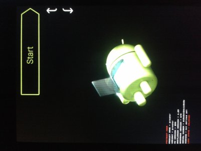

First off, you need to 'break' out of the bootloop... by booting into the bootloader.
1). Press and hold the VOLUME-DOWN button...
2). Whilst holding, press the POWER button...
3). Maintain your hold on both buttons until the device boots into the bootloader.
See my first attached screenshot for what the bootloader looks like.

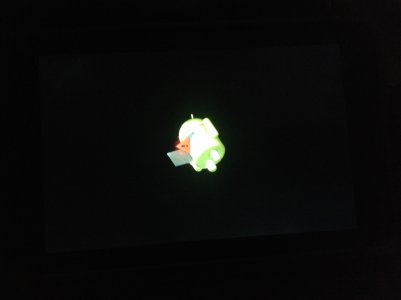

Your Nexus 7 should now boot into Recovery.
See my second attached screenshot of what you should expect to see...
...which, granted, initially isn't much:(. A green android lying on it's back... and a black exclamation mark in a red triangle poking out of its 'stomach'. The stock recovery doesn't seem to offer much in the way of user interaction. If the Nexus 7 is left in this state for 120 seconds, the device will reboot automatically.
