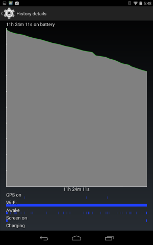

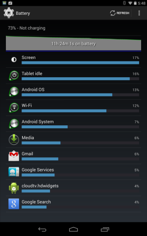

Has anyone seeing battery life like what I am seeing? I unplugged my tablet this morning, used it for a few minutes and then left it at home while I went to work. When I got home, it was at 73%. See the attached battery graphs. I didn't get a shot of the screen on time, but as you can see, almost all of the time was with the screen off.

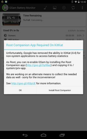

Looks like GSAM Battery Monitor won't work on Kit Kat yet for non-root users...

GSam Battery Monitor is now compatible with KitKat, so it's worth installing it to get a better breakdown of battery use.

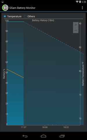

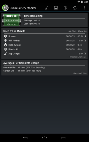

am suddenly seeing faster battery drain as well (no bluetooth, location services, nfc)...i DO use wifi... GSam battery monitor shows the screen as the biggest power drain... and mine's set to less than 50% (as it's always been)... (followed by android os kernel, and wifi). but the screen currently shows "82.4%"...and I've barely had it on today...
Re: Battery Life
Can you post a screenshot of the GSam stats, and also the graph?
From time to time, I notice my 2012 N7 will suddenly start draining fast, and I haven't been able to pinpoint any app that is causing it. Just happened last night, and I was able to ascertain that the screen was actually on for a few hours, causing the drain. Which is weird, because it was just sitting untouched, with the smartcover closed, which should have kept the screen off. If I figure out anything more about it, I'll post an update.
Re: Battery Life
Actually, why don't you wait a few hours of typical usage, and then post the battery stats and graph again? What you just posted isn't entirely helpful, because the battery is still at 100%, and GSam is simply trying to extrapolate the battery life based on previous usage.
Re: Battery Life
LOL, of course! i had JUST charged the N7... will see how things look later...
