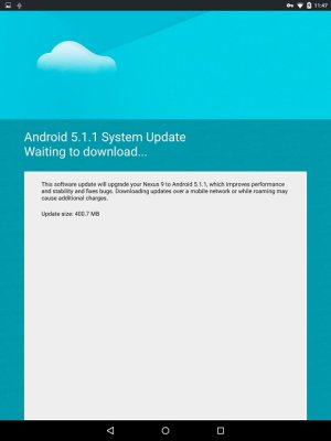

I just got a notification to get the OTA. States 'waiting to download' and no sort of button or anything else I can do. Wonder how long I have to wait for and candidly, why I am waiting?
**EDIT - About 5 minutes after posting this is changed to Downloading** Fingers crossed I have no issues.
