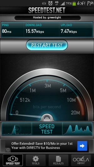

Now I'm finally enjoying the LTE around me! :D
Maybe not as fast as other carriers but also not as pricey!
Sent From a Galaxy S4 Away!
