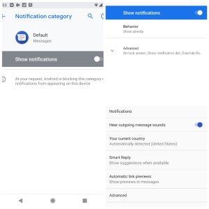

Here is what I found on my Pixel 2. Apparently the Pie update reset the notification settings on Messages app.
From within the Messages app, select Settings --> Notifications --> Show Notifications
You'll also see options to select sound, show bubble, etc.
Hope that helps!

Resolved; Setting, App Info, scroll down to Messages, then Notifications, turn everything on. You will find the notifications are off and in the Advanced section too. Turn them all back on.
The update must have turned them all off.
Hope this helps 😊

Thanks Steg, had this problem on a fresh Mi Mix 3 and this was the fix. When you view the settings in app they are limited but settings > installed apps > messages shows much more fine-grained control. Turns out that after syncing to desktop, there's *separate notification settings* for when desktop sync is enabled.
