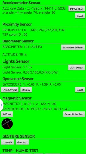

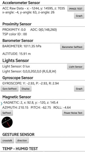

This what mine looks like with hand in front of sensor and off of sensor.
Tappin From My N3

So when you put your hand over sensor, it turns green. But when you remove the hand does it go back to normal?
Can you please check to see if the sensor works during an actual call?
Thanks

Correct when I put my hand over it. Goes Green and soon as I remove back to white. And same thing for in calls when I pull the phone away from my face screen lights up as normal.
