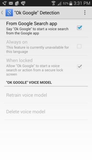

if you are not using svoice this option is grayed out
If your screen is turn off, and you say Ok Google, and hear the noise but the screen stays off and you can't really do anything, ENABLE the lockscreen, then it will work from screen off, apparently currently you have to have the lockscreen enabled for it to wake up to a normal Google Now screen like the Moto X does

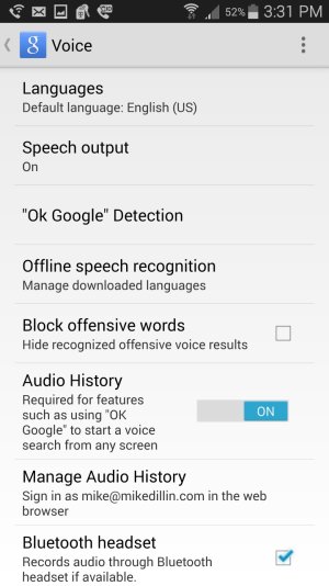

I was having that problem from the google now launcher. What I did was go to the google search app, not the google now screen to the left, then select the menu button on the top left, then select settings. From there I selected "voice", then " google now detection" and I was able to enable it from any screen and when screen is off while charging.
